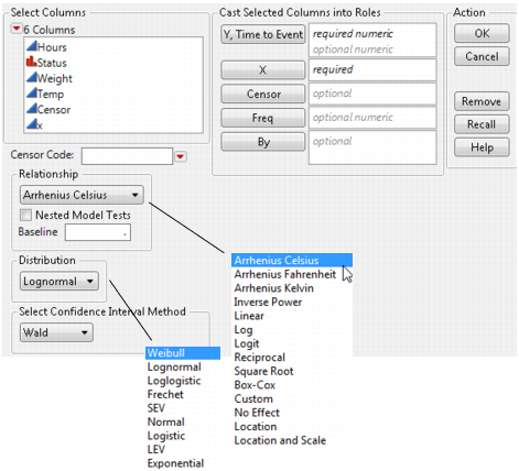

Launch the Fit Life by X platform by selecting Analyze > Reliability and Survival > Fit Life by X.
Identifies the time to event (such as the time to failure) or time to censoring. With interval censoring, specify two Y variables, where one Y variable gives the lower limit and the other Y variable gives the upper limit for each unit. For details about censoring, see Event Plot in Life Distribution.
If you select Location or Location and Scale, a message might appear stating that “Analysis must exclude groups that are all right censored to continue Nested Model Tests. Do you want to continue?” Click Yes to continue the analysis. Right censored groups indicate groups where all observations are right censored. The message does not appear if your sample data does not include right censored observations.
See Custom Relationship if you want to use a Custom relationship for your model.
Note: The Confidence Interval Method preference enables you to select the Likelihood method as the default confidence interval method. You can change this preference in Preferences > Platforms > Fit Life by X.
