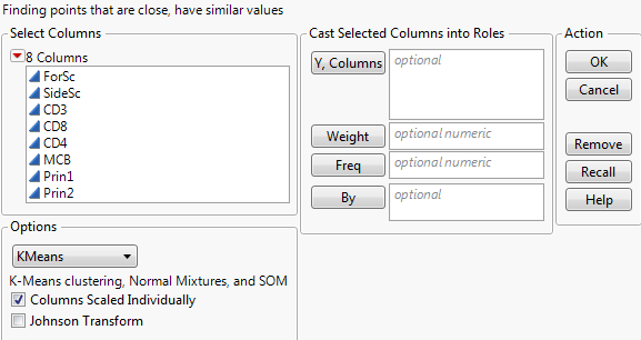

Launch the K Means Cluster platform by selecting Analyze > Clustering > K Means Cluster. K Means Cluster Launch Window shows the Clustering launch window for Cytometry.jmp.
Note: K-Means clustering supports only numeric columns.
KMeans is the default clustering method, but you have the option to select Hierarchical or Normal Mixtures. If you select KMeans or Normal Mixtures, when you click OK, a Control Panel appears. See Iterative Clustering Control Panel.
