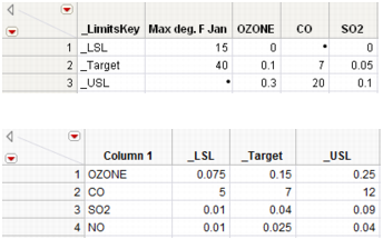

All limits data tables must have a column for each of the variables whose values are the known standard parameters or limits. A limits data table can be in two different formats: wide or tall. Either you have a column for each response with the limits key or you have one column for each response and the limits key words are the columns. Either of these formats can be read using the Import Spec Limits command. Wide (Top) and Tall (Bottom) Spec Limit Tables shows an example of both types of limits data tables.
A wide table contains one column for each column analyzed in the Capability platform, with three rows plus a _LimitsKey column. In the _LimitsKey column, the three rows need to contain the identifiers _LSL, _USL, and _Target.
