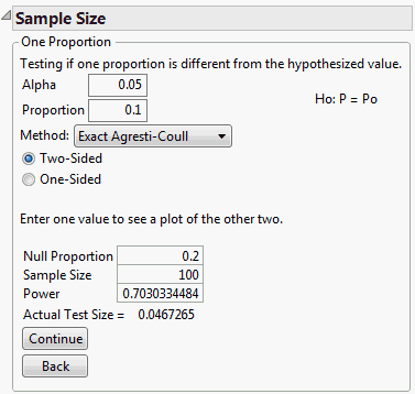

Click One Sample Proportion.
Leave Alpha as 0.05.
Leave 0.1 as the value for Proportion.
Leave the Method as Exact Agresti-Coull.
Accept the default option of Two-Sided. (A one-sided test is selected if you are interested in testing if the proportion is either greater than or less than the Null Proportion.)
Leave 0.2 as the value for Null Proportion.
Enter 100 as the Sample Size.
Click Continue.
The Power is calculated and is shown as approximately 0.7 (see Power and Sample Window for One-Sample Proportions). Note the Actual Test Size is 0.0467, which is slightly less than the desired 0.05.
