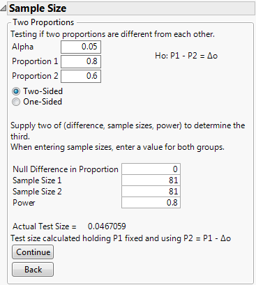

Select DOE > Design Diagnostics > Sample Size and Power.
Click Two Sample Proportions.
Enter 0.08 for Proportion 1.
5.
Enter 0.06 for Proportion 2.
7.
Enter 0.0 for Null Difference in Proportion.
8.
9.
Leave Sample Size 1 and Sample Size 2 blank.
10.
Click Continue.
The Sample Size window shows sample sizes of 2554. (see Difference Between Two Proportions for a Two-Sided Test.) Testing for a one-sided test is conducted similarly. Simply select the One-Sided option.

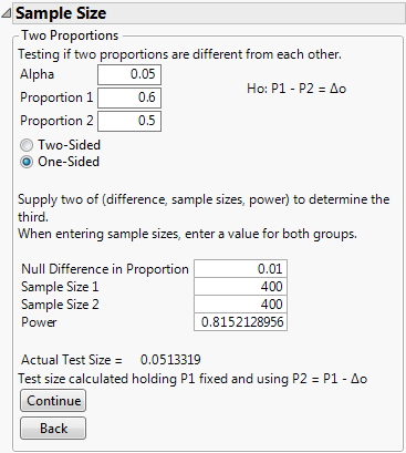

Enter 0.6 for Proportion 1.
5.
Enter 0.5 for Proportion 2.
6.
Select One-Sided.
7.
Enter 0.01 as the Null Difference in Proportion.
8.
Enter 400 for Sample Size 1.
9.
Enter 400 for Sample Size 2.
10.
Leave Power blank.
11.
Click Continue.
Difference Between Two Proportions for a One-Sided Test shows the Two Proportions windows with the estimated Power calculation of 0.82.
