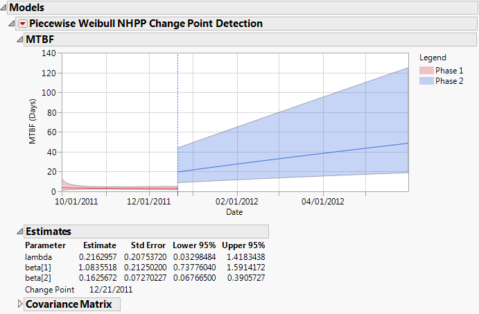

The default Piecewise Weibull NHPP Change Point Detection report shows the MTBF plot, Estimates, and Covariance Matrix. (See Piecewise Weibull NHPP Change Point Detection Report, which uses the data in BrakeReliability.jmp, found in the Reliability subfolder.) Note that the Change Point, shown at the bottom of the Estimates report, is estimated as 12/21/2011. The standard errors and confidence intervals consider the change point to be known. The plot and the Estimates report are described in the section Piecewise Weibull NHPP.
