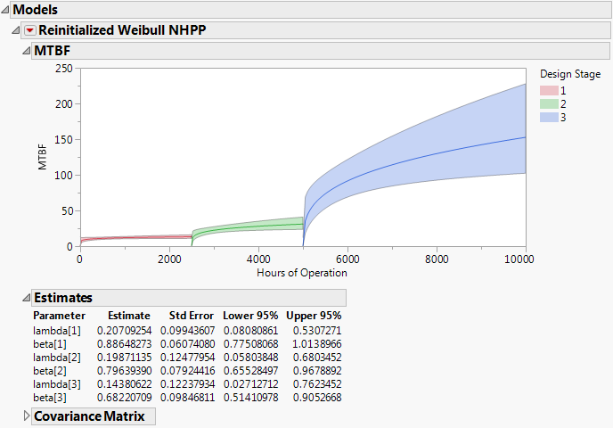

By default, the Reinitialized Weibull NHPP report shows the estimated MTBF plot. The phases are differentiated with different colors. The Estimates and Covariance Matrix reports are shown below the plot. (See Reinitialized Weibull NHPP Report, which uses the ProductionEquipment.jmp sample data file from the Reliability subfolder.)
The MTBF plot opens by default when the Reinitialized Weibull NHPP option is chosen. For further details about the plot, see MTBF Plot.
The Estimates report gives estimates of λ and β for each of the phases. For a given phase, λ and β are estimated using only the data from that phase. The calculations assume that the phase begins at time 0 and reflect whether the phase is failure or time terminated, as defined by the data table structure (see Test Phases). Also shown are standard errors and 95% confidence limits. These values are computed as described in Parameter Estimates for Crow-AMSAA Models.
