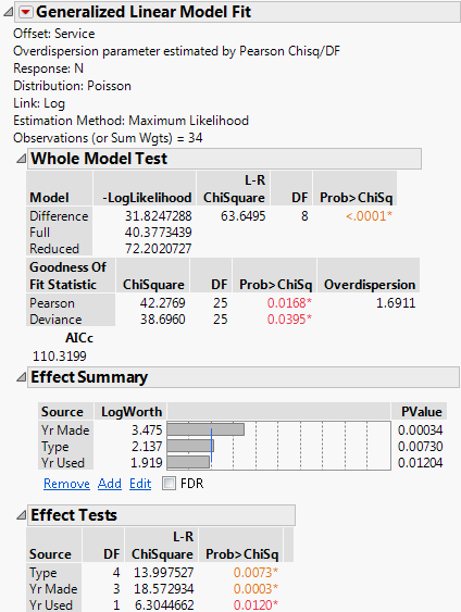

Click the check mark box for Overdispersion Tests and Intervals.
9.
Click Run.
From the report shown in Partial Report for a Poisson with Offset Model, notice that all three effects (Type, Yr Made, Yr Used) are significant.
