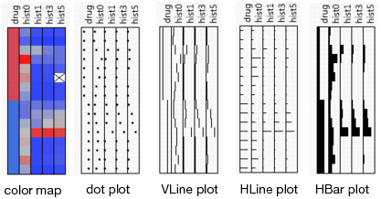

Use the Graph Type option to change the appearance of the graph.
