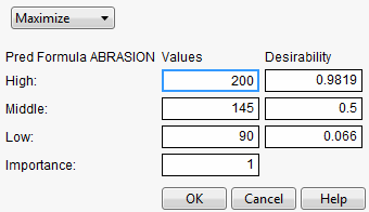

Shows or hides the desirability functions. Desirability is discussed in Desirability Profiling and Optimization.
Note: In many situations, the settings that optimize the desirability function are not unique. The Maximize Desirability option gives one such setting. The Contour Profiler is a good tool for finding alternative factor combinations that optimize desirability. For an example, see Explore Optimal Settings in Contour Profiler.

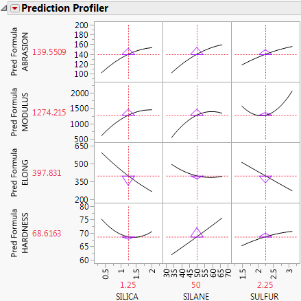

Shows or hides a purple triangle whose height and direction correspond to the value of the partial derivative of the profile function at its current value (see Sensitivity Indicators). This is useful in large profiles to be able to quickly spot the sensitive cells.
