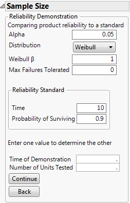

To launch the Reliability Demonstration calculator, select DOE > Design Diagnostics > Sample Size and Power, and then select Reliability Demonstration. Reliability Demonstration Window shows the Reliability Demonstration window.
is the assumed failure distribution. After selecting a distribution, specify the associated scale parameter in the text field under the Distribution menu.
Select Reliability Demonstration.
Select Weibull from the Distribution list.
5.
Enter 2 for Max Failures Tolerated.
6.
Enter 1000 for Time.
7.

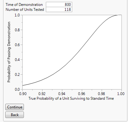

Enter 0.9 for Probability of Surviving.
8.
Enter 800 for Time of Demonstration.
