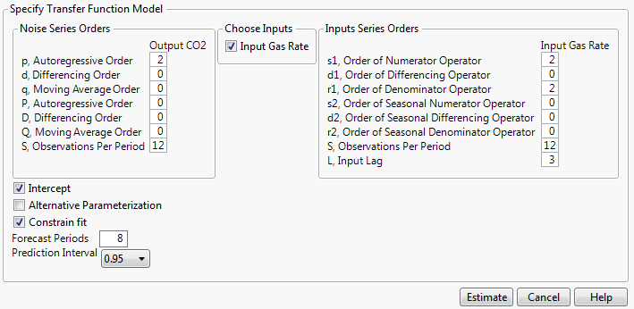

(Available only in the Transfer Function Analysis red triangle menu.) Shows the Transfer Function Model Specification window. Building a transfer function model is similar to building an ARIMA model; it is an iterative process of exploring, fitting, and comparing models. Before building a model and during the data exploration process, it is sometimes useful to prewhiten the data. See Statistical Details for Transfer Functions.
Note: Currently, the transfer function model platform has limited capability of supporting missing values.
Specifies whether μ is zero.
Once you specify the models and click Estimate, a Model Report for each specified model is added to the report window. See Reports.
