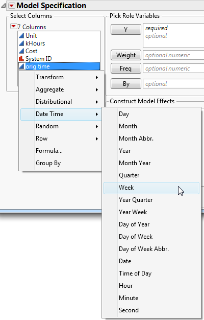

Select a function from the Transform menu to create a transform column containing the calculations based on the selected function. For details, see the Scripting Index in the Help menu or Transform in the Fitting Linear Models.

For column values containing date or time values, select a function from the Date Time menu to create a transform column containing values calculated from the selected column. For details, see the Scripting Index in the Help menu.
