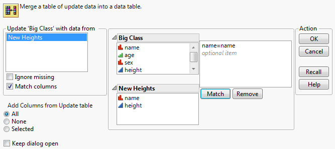

Select Match columns.
This Window Appears When You Click Match Columns
Click Match.
6.
