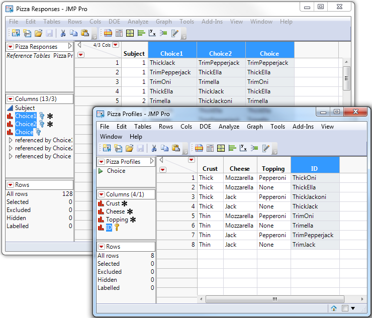

Virtually Joined Data Tables shows an example of virtually joined data tables. Pizza Profiles.jmp is the referenced data table because the ID column contains a Link ID column property. The ID column contains unique values that correspond to data in the referencing data table, Pizza Responses.jmp.
Note: The key icon in the Columns panel (in Pizza Responses.jmp above) is blue when the columns are linked and the referenced columns appear in the Columns panel. If the key icon is gray, verify your link references in the Column Info window.
This column contains unique values that correspond to values in Pizza Responses.jmp. For example, row one in Pizza Profiles.jmp indicates that pizza with thick crust, mozzarella cheese, and pepperoni toppings is nicknamed ThickOni. When all responses in Pizza Responses.jmp are “ThickOni”, the subject chose pizza with these attributes.

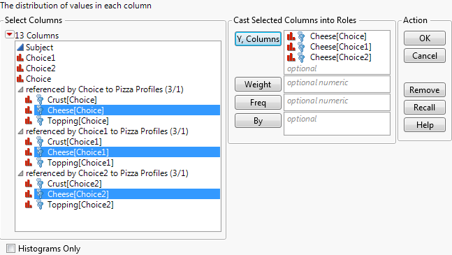

In Pizza Responses.jmp, select the three columns that begin with “Choice”.
The selected columns are linked to the ID column in Pizza Profiles.jmp and appear in the main data table’s Columns list (Virtually Joined Data Tables).
Note: Look at one of the column’s Link Reference properties again and notice that the Pizza Profiles.jmp data table is selected. See Virtual Join Properties in The Column Info Window for information about changing the link.

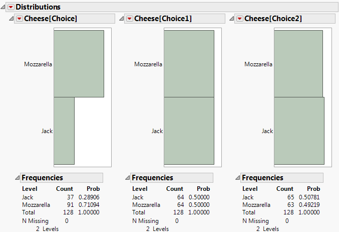

Scroll down to select the three Cheese columns in the referenced column groups, click Y, Columns, and click OK.
More respondents chose Mozzarella in the Choice column. In Choice1 and Choice2, the proportion of Mozzarella to Jack is nearly even.
