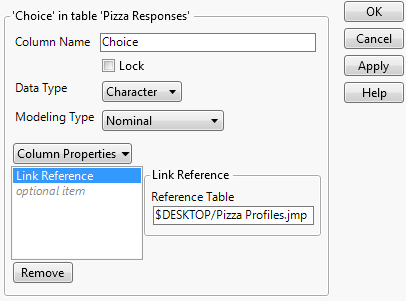

The Link Reference column property maps a column in the main data table to the ID column in the referenced data table. The column that has a link reference is referred to as the referencing column. The referencing column can look up the data of the auxiliary data tables through the ID column.
To add the Link Reference column property, select the column, select Cols > Column Info, and then select Link Reference from the Column Properties list. Enter the path to the main table and click OK. If you enter the path correctly, the referenced columns show up in the Columns panel of the main table after you click OK.
You can also increase portability by using a JMP path variable in the Link Reference path. Link Reference Column Property Definition shows an example. Enter a forward slash in the path to share the data tables with both Windows and Macintosh users. See Path Variables in the Scripting Guide for details about path variables.
