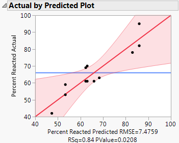

The Whole Model actual-by-predicted plot, shown in An Actual-by-Predicted Plot, appears at the top of the Fit Model report. You see at a glance that this model fits well. The blue line falls outside the bounds of the 95% confidence curves (red-dotted lines), which tells you the model is significant. The model p-value (p = 0.0208), R2, and RMSE appear below the plot. The RMSE is an estimate of the standard deviation, assuming that the unestimated effects are negligible.

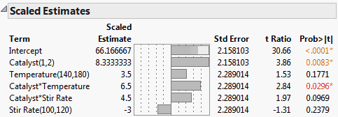

To see a scaled estimates report, use Effect Screening > Scaled Estimates found in the red triangle menu on the Response Percent Reacted title bar. When there are quadratic or polynomial effects, the coefficients and the tests for them are more meaningful if effects are scaled and coded. The Scaled Estimates report includes a bar chart of the individual effects embedded in a table of parameter estimates. The last column of the table has the p-values for each effect.

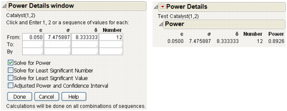

Open the Effect Details disclosure icon to see outline nodes for the Catalyst and Temperature effects. To run a power analysis for an effect, click the red triangle icon on its title bar and select Power Analysis.
This example shows a power analysis for the Catalyst variable, using default value for α (0.05), the root mean square error and parameter estimate for Catalyst, for a sample size of 12. The resulting power is 0.8926, which means that in similar experiments, you can expect an 89% chance of detecting a significant effect for Catalyst.
