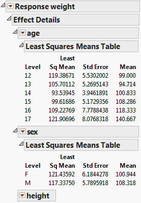

The Effect Details report, shown in Least Squares Mean Table, shows reports for each of the three effects. Least Squares Means tables are given for age and sex, but not for the continuous effect height. Notice how the least squares means differ from the sample means.

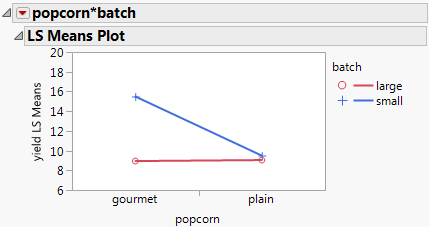

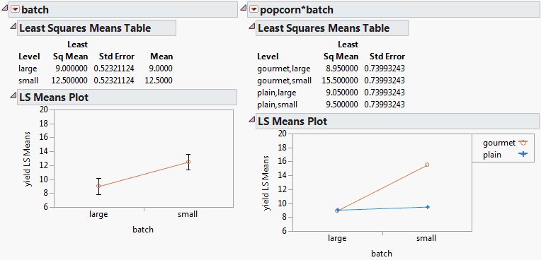

This option constructs least squares means (LS Means) plots for nominal and ordinal main effects and their interactions. The Popcorn.jmp sample data table illustrates an interaction between two categorical effects. Least Squares Means Tables and Plots for Two Effects shows the Least Squares Means tables and the corresponding LS Means plots for two categorical effects in the Popcorn.jmp sample data table.
To create the report in Least Squares Means Tables and Plots for Two Effects, follow these steps:
Select Analyze > Fit Model.
Select popcorn, oil amt, and batch and click Macros > Full Factorial. Note that the Emphasis changes to Effect Screening.
5.
Click Run.
7.
8.
To transpose the factors in the plot for popcorn*batch, deselect the LSMeans plot option. Then hold the Shift key while you select the LSMeans Plot option again.
LSMeans Plot for Interaction with Factors Transposed shows the popcorn*batch interaction plot with the factors transposed. Compare it with the plot in Least Squares Means Tables and Plots for Two Effects. These plots depict the same information but, depending on your interest, one might be more intuitive than the other.

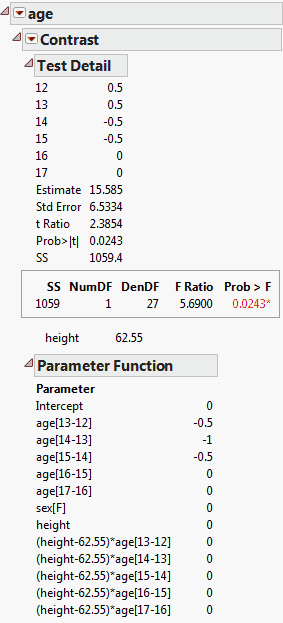

A contrast is a linear combination of parameter values. In the Contrast Specification window, you can specify multiple contrasts and jointly test whether they are zero (LSMeans Contrast Specification for age).
Each time you click the + or - button, the contrast coefficients are normalized to make their sum zero and their absolute sum equal to two, if possible. To compare additional levels, click the New Column button. A new column appears in which you define a new contrast. After you are finished, click Done. The Contrast report appears (LSMeans Contrast Report). The overall test is a joint F test for all contrasts.
p-value for the significance test
The Test Detail report (LSMeans Contrast Report) shows a column for each contrast that you tested. For each contrast, the report gives its estimated value, its standard error, a t ratio for a test of that single contrast, the corresponding p-value, and its sum of squares.
The Parameter Function report (LSMeans Contrast Report) shows the contrasts that you specified expressed as linear combinations of the terms of the model.

The Contrast report is shown in LSMeans Contrast Report. The test for the contrast is significant at the 0.05 level. You conclude that the predicted weight for age 12 and 13 children differs statistically from the predicted weight for age 14 and 15 children at the mean height of 62.55.

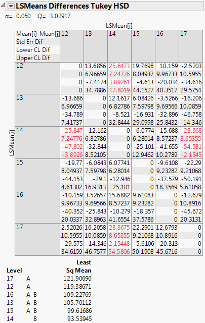

LSMeans Tukey HSD Report shows the LSMeans Tukey report for the effect age in the Big Class.jmp sample data table. (You can obtain this report by running the Fit Model data table script and selecting LS Means Tukey HSD from the red triangle menu for age.) By default, the report shows the Crosstab Report and the Connecting Letters Report.

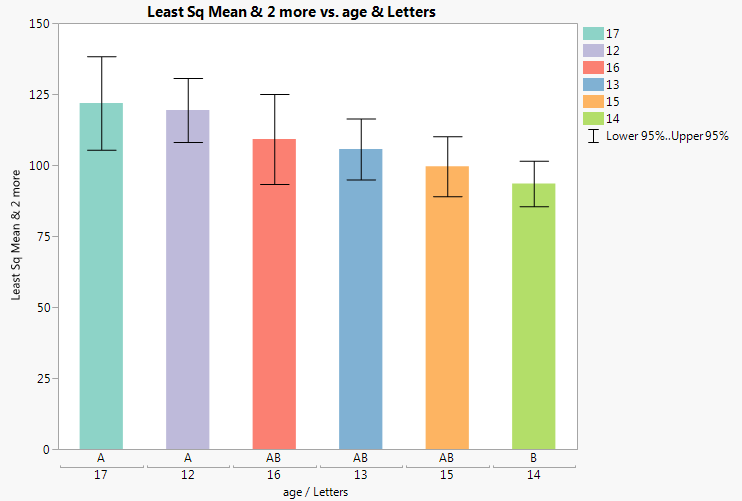

In LSMeans Tukey HSD Report, levels 17, 12, 16, 13, and 15 are connected by the letter A. The connection indicates that these levels do not differ at the 0.05 significance level. Also, levels 16, 13, 15, and 14 are connected by the letter B, indicating that they do not differ statistically. However, ages 17 and 14, and ages 12 and 14, are not connected by a common letter, indicating that these two pairs of levels are statistically different.
Bar Chart from LSMeans Differences HSD Connecting Letters Table shows the bar chart for an example based on Big Class.jmp. Run the Fit Model data table script, select LSMeans Tukey HSD from the red triangle menu for age. Select Save Connecting Letters Table from the LSMeans Differences Tukey HSD report. Run the Bar Chart script in the data table that appears.

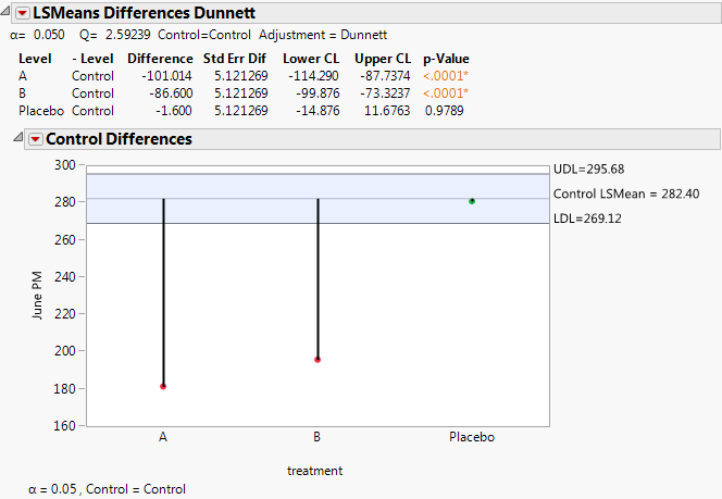

A report for the LSMeans Dunnett option for effect treatment in the Cholesterol.jmp sample data table is shown in LSMeans Dunnett Report. Here, the response is June PM and the level of treatment called Control is specified as the control level.
