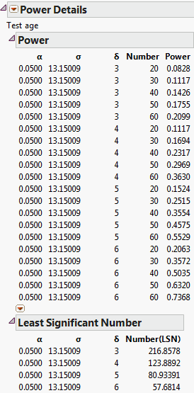

This example illustrates a retrospective power analysis using the Big Class.jmp sample data table. The Power Details window (Power Details Window for Age) permits exploration of various quantities over ranges of values for α, σ, δ, and Number, or study size. Clicking Done replaces the window with the results of the calculations.
Select Analyze > Fit Model.
5.
Click Run.
6.
7.

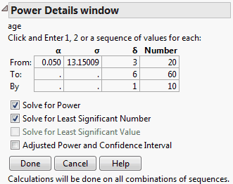

Replace the δ value in the From box with 3, and enter 6 and 1 in the To and By boxes as shown in Power Details Window for Age.
8.
Replace the Number value in the From box with 20, and enter 60 and 10 in the To and By boxes as shown in Power Details Window for Age.
9.
10.
Click Done.
11.
This analysis is a retrospective power analysis because the calculations assume a study with a structure identical to that of the Big Class.jmp sample data table. For example, the calculation of power in this example depends on the effects entered into the model and the number of subjects in each age and sex grouping. Also, the value of σ was derived from the current study, though you could have replaced it with a value that would be representative of a future study.
For details about the power results shown in Power Details Report for Age, see Power. For details about the least significant number (LSN), see The Least Significant Number (LSN).

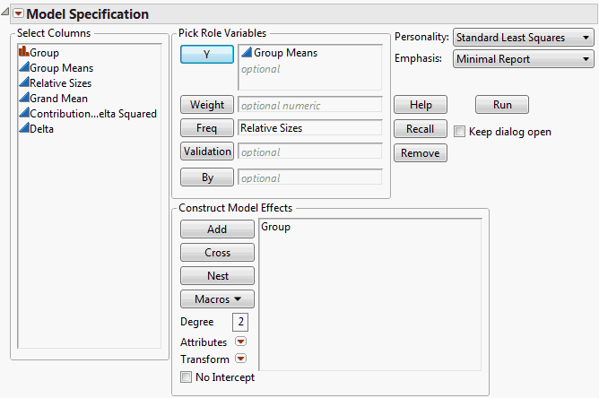

Next, use Fit Model to fit a one-way analysis of variance model (Fit Model Launch Window for Bacteria Study). Note that Relative Sizes is declared as Freq in the launch window. Also, the Minimal Report emphasis option is selected.

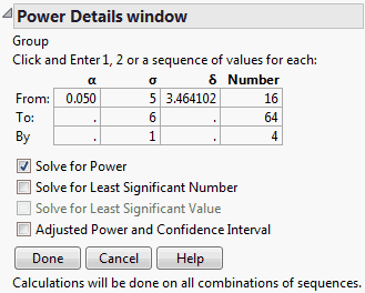

To explore the range of error variation suspected by the scientist, under σ, enter 5 in the first box and 6 in the second box (Power Details Window for Bacteria Study).
Note that δ is entered as 3.464102. This is the effect size that corresponds to the specified difference in the group means. The data table contains three hidden columns that illustrate the calculation of the effect size. (See Unbalanced One-Way Layout.)
5.
To explore power over a range of study sizes, under Number, enter 16 in the first box, 64 in the second box, and an increment of 4 in the third box (Power Details Window for Bacteria Study).
6.
Select Solve for Power.
7.
Click Done.

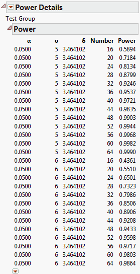

The Power Details report, shown in Power Details Report for Bacteria Study, replaces the Power Details window. This report gives power calculations for α = 0.05, for all combinations of σ = 5 and 6, and sample sizes of 16 to 64 in increments of size 4. When σ is 5, to obtain about 90% power, you need a total sample size of about 32. You need 16 subjects in the control group and 8 in each of the treatment groups. On the other hand, if σ is 6, then a total of 44 subjects is required.

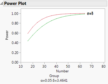

Click the arrow at the bottom of the table in the Power Details report to obtain a plot of power versus sample size for the two values of σ, shown in Power Plot for Bacteria Study. Here, the red markers correspond to σ = 5 and the green correspond to σ = 6.
