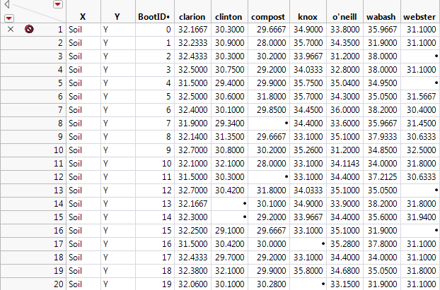

In the Means for Oneway Anova report, right-click the Mean column and select Bootstrap.
8.
Type 1000 for the Number of Bootstrap Samples.
9.
(Optional) To match the results in Figure 10.136, type 12345 for the Random Seed.
10.
Figure 10.136 Bootstrap Results for a Simple Bootstrap
The missing values in Figure 10.136 represent bootstrap iterations in which none of the observations for a given soil type were selected for the bootstrap sample.

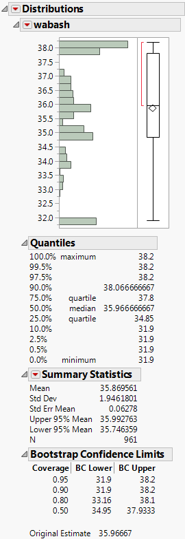

Figure 10.137 Distribution of wabash Means from a Simple Bootstrap
Figure 10.137 shows the distribution of wabash means from the simple bootstrap analysis. Notice the following:
The Summary Statistics report indicates that the number of rows containing bootstrap means for wabash is N = 961. Although you conducted 1,000 iterations, 39 bootstrap samples did not contain any of the three observations for wabash.
The histogram of sample means is not smooth, with peaks at the two extremes. The three values for wabash are 38.2, 37.8, and 31.9. The peak at the low end of the distribution results from bootstrap samples that contain only the value 31.9. The peak at the high end results from bootstrap samples that contain one or both of the values 38.2 and 37.8.

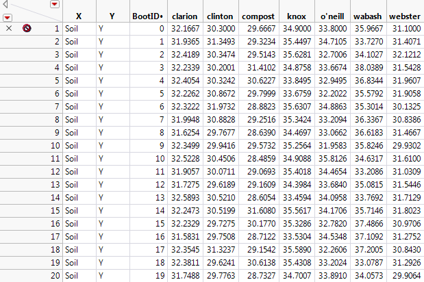

In the Oneway Analysis report, right-click the Mean column in the Means for Oneway Anova report and select Bootstrap.
(Optional) To match the results in Figure 10.138, type 12345 for the Random Seed.
Select the Fractional Weights option.
5.
Figure 10.138 Bootstrap Results for a Bayesian Bootstrap
There are no missing values in the Bayesian Bootstrap results table. All 21 rows in the Snapdragon.jmp data table are included, with varying bootstrap weights, in each bootstrap sample.

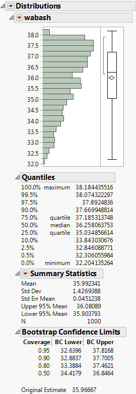

Figure 10.139 Distribution of wabash Means from a Bayesian Bootstrap
The Bayesian Bootstrap produces a much smoother distribution for the wabash sample means. All 1,000 bootstrap samples include the three observations for wabash. For each iteration, the wabash sample mean is calculated using different fractional weights.
