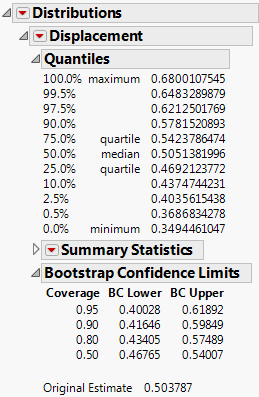

The Distribution platform provides summary statistics for your bootstrap results. It also produces a Bootstrap Confidence Limits report for any table that contains a BootID• column (Figure 10.135).
The Quantiles report provides percentile intervals. For example, to construct a 95% confidence interval using the percentile method, use the 2.5% and 97.5% quantiles as the interval bounds.
The Bootstrap Confidence Limits report provides bias-corrected percentile intervals. The report shows intervals with 95%, 90%, 80%, and 50% coverage levels. The BC Lower and BC Upper columns show the lower and upper endpoints, respectively. For more information about the computation of the bias-corrected percentile intervals, see Bias-Corrected Percentile Intervals.
Figure 10.135 Bootstrap Confidence Limits Report
The Original Estimate at the bottom of the Bootstrap Confidence Limits report is the estimate of the statistic using the original data.
