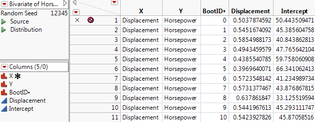

Select Split Selected Column to create a bootstrap table that contains separate columns for the report column that you selected. Each column corresponds to a Term in the report table. For example, in Figure 10.134, the Estimate column from Figure 10.133 is split into two columns (Displacement and Intercept), one for each level of Term.
Figure 10.134 Unstacked Bootstrap Results Table
The data table columns used in the analysis appear in the table. In this example, X is Displacement, and Y is Horsepower.
The BootID• column identifies the bootstrap sample. The row where BootID• = 0 corresponds to the original estimates. That row is marked with an X and has the excluded row state. In the unstacked bootstrap table, each row is calculated from a single bootstrap sample.
