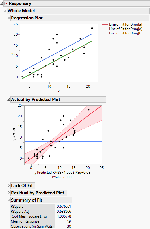

The Regression Plot in the report shows that you have fit a model with equal slopes (Figure 3.4). Compared to the main effects model (Drug effect only), RSquare increases from 22.8% to 67.6%. The Root Mean Square Error decreases from 6.07 to 4.0. As shown in Figure 3.4, the F test significance probability for the whole model decreases from 0.03 to less than 0.0001.
Figure 3.4 Analysis of Covariance for Drug Data

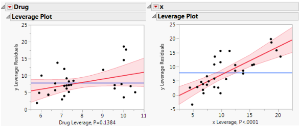

Figure 3.5 shows a leverage plot for each effect. Because the covariate is significant, the leverage values for Drug are dispersed somewhat from their least squares means.
