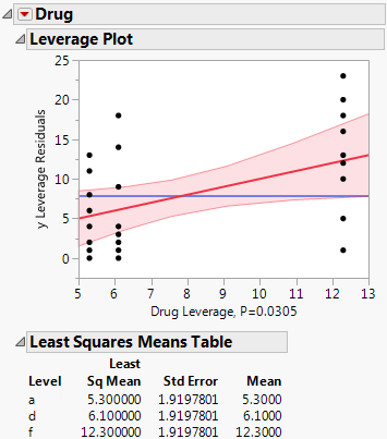

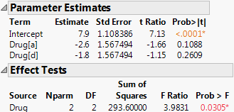

Figure 3.1 shows the Leverage Plot and the LS Means Table for the Drug effect. Figure 3.2 shows the Parameter Estimates and the Effect Tests reports for the one-way analysis of the drug data.
Figure 3.1 Leverage Plot and LS Means Table for Drug
Figure 3.2 Parameter Estimates and Effect Tests for Drug.jmp

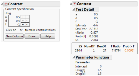

The Drug effect can be studied in more detail by using a contrast of the least squares means, as follows:
From the red triangle menu next to Drug, select LSMeans Contrast.
Click the + boxes for drugs a and d, and the - box for drug f to define the contrast that compares the average of drugs a and d to f (shown in Figure 3.3).
Click Done.
Figure 3.3 Contrast Example for the Drug Experiment
The Contrast report shows that the LSMean for drug f is significantly different from the average of the LSMeans of the other two drugs.
