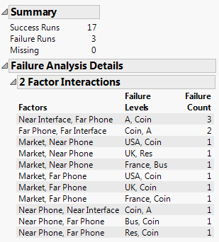

In the Table panel, click the green triangle next to the Analysis script.
Figure 19.16 Analysis of Phone Experimental Data
The 2 Factor Interactions report shows the combinations that might have caused the three failures. It is possible that one combination, Near Interface set to A and Far Phone set to Coin, is responsible for all three failures. Or it is possible that two or three other combinations caused the three failures.
In the data table, rows 1, 3, and 15 are selected. Failures occur for these combinations, regardless of the settings for Market, Near Phone, and Far Interface. But note that other combinations of factor settings could account for these failures as well.
