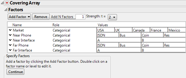

Select DOE > Special Purpose > Covering Array.
Notice that the menu next to Strength: t = , is set to 2 by default.
From the Covering Array red triangle menu, select Load Factors.
Figure 19.10 Factors Outline for Phone Factors
Click Continue.

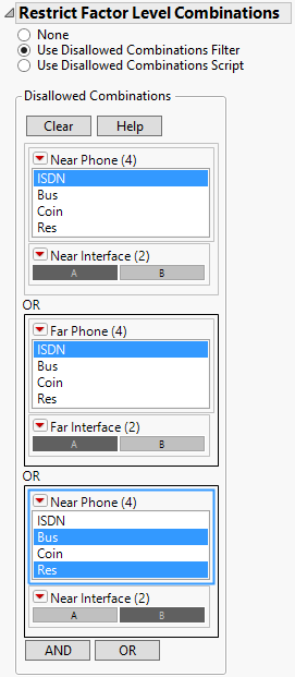

The filter gives an intuitive way to specify disallowed combinations. The script provides a quick and easy way to specify disallowed combinations, but requires that you have written or saved a script. In this example, if you do not want to specify combinations using the filter, skip to Specify Disallowed Combinations Using a Script.
Use this approach to enter disallowed combinations using the filter interface. Alternatively, you can paste a script as shown in Specify Disallowed Combinations Using a Script.
Select Use Disallowed Combinations Filter.
Click OR.
5.
6.
You have added the constraint that an ISDN line on the receiving phone (Far) cannot use interface A.
7.
Click OR.
8.
9.
Figure 19.12 Completed Disallowed Combinations Filter

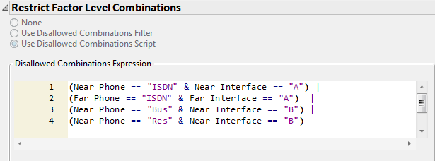

Alternatively, you can specify disallowed combinations by constructing a script. After loading your factors (Load Factors), do the following:
Click Continue.
Select Use Disallowed Combinations Script.
(Near Phone == "ISDN" & Near Interface == "A") |
(Far Phone == "ISDN" & Far Interface == "A") |
(Near Phone == "Bus" & Near Interface == "B") |
(Near Phone == "Res" & Near Interface == "B")
Figure 19.13 Completed Disallowed Combinations Script Window

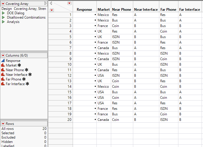

Click Make Table.
Figure 19.15 Covering Array Design Table
