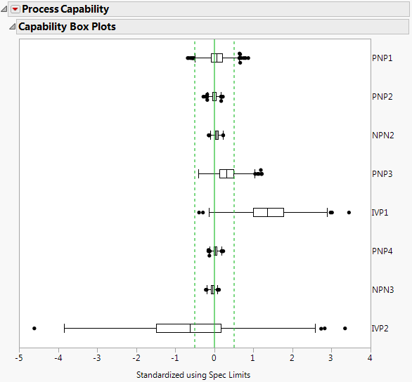

Figure 10.11 shows a Capability Box Plots report for eight variables in the Semiconductor Capability.jmp sample data table.
Figure 10.12 Capability Box Plot
This plot is useful for comparing variables with respect to their specification limits. For example, in Figure 10.12, the majority of points for IVP1 are above its USL, and the majority of its points for IVP2 are less than its target. PNP2 seems to be on target with all data points in the specification limits.
