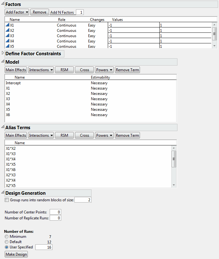

Select DOE > Custom Design.
Type 6 next to Add N Factors.
Click Add Factor > Continuous.
Click Continue.
5.
Select Optimality Criterion > Make Alias Optimal Design from the red triangle menu.
The Make Alias Optimal Design selection tells JMP to generate a design that balances reduction in aliasing with D-efficiency. See Alias Optimality in Custom Designs.
6.
Click User Specified and change the number of runs to 16.

Click Make Design.

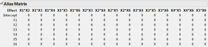

Open the Design Evaluation > Alias Matrix outline.
Figure 4.10 Alias Matrix

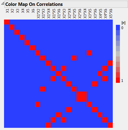

Open the Design Evaluation > Color Map on Correlations outline.
Figure 4.11 Color Map on Correlations
