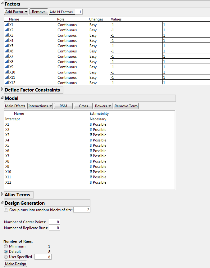

Select DOE > Custom Design.
Type 12 next to Add N Factors.
Click Add Factor > Continuous.
Click Continue.
6.
Setting the effects to If Possible ensures that JMP uses the Bayesian D-optimality criterion to obtain the design.
Figure 4.12 Factors, Model, and Number of Runs

Click Make Design.

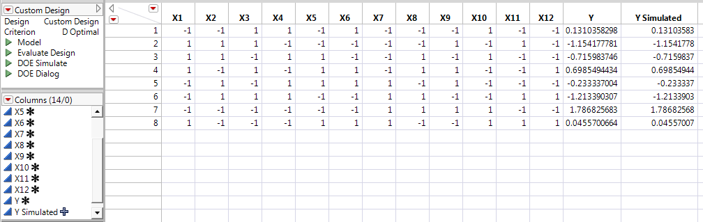

Click Make Table.
Figure 4.13 Design Table with Simulated Responses
The response columns, Y and Y Simulated, are initiated with the same simulated values. The values are random values from a N(0, s) distribution. where s is the RMSE from the power analysis dialog with a default of 1. The Y Simulated values are updated with randomly generated values using the model defined by the parameter values in the Simulate Responses window. The Y column is intended for your true responses after the experiment has be run.

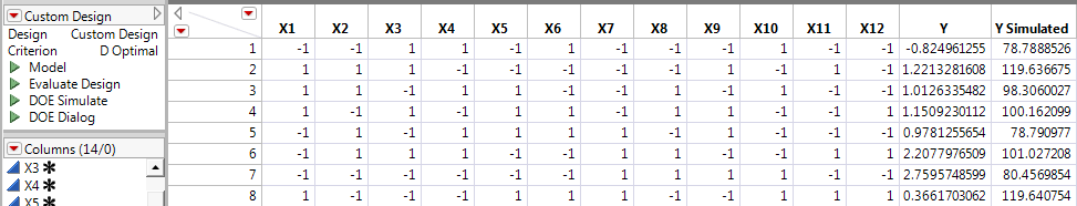

Note: The response values are randomly generated. Your values will not match those in Figure 4.16 exactly.
Figure 4.16 Y Simulated Response Column with X1 and X11 Active
In your simulation, you specified X1 and X11 as active factors with large effects relative to the error variation. For this reason, your analysis of the data should identify these two factors as active.

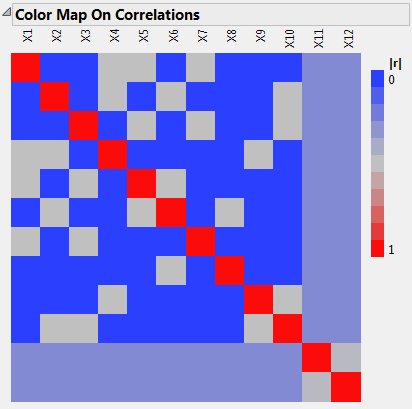

You might also want to check whether the effects that appear active could be highly correlated with other effects. When this occurs, one effect can mask the true significance of another effect. The Color Map in Figure 4.19 displays absolute correlations between effects.

In your Custom Design window, open the Design Evaluation > Color Map on Correlations outline.
Figure 4.19 Color Map on Correlations Outline
With your cursor, place your mouse pointer over cells to see the absolute correlations. Notice that X1 has correlations as high as 0.5 with other main effects (X4, X5, X7). (Figure 4.19 uses JMP default colors.)
