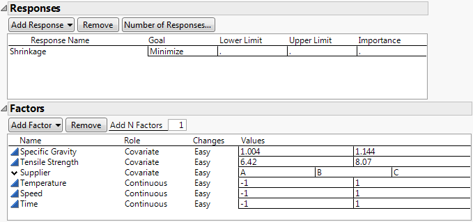

You want to study the effects of three controllable factors, Temperature (mold temperature), Speed (screw speed), and Time (hold time), on Shrinkage. But you also want to study the effects of the covariates: Specific Gravity, Tensile Strength, and Supplier. Your resources allow for 12 runs.

Type 3 next to Add N Factors.
8.
Click Add Factor > Continuous.
9.
Figure 4.62 Responses and Factors Outlines

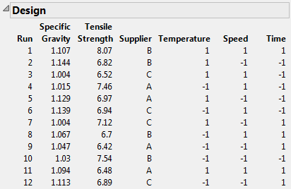

Type 12 next to Number of Runs.
Note: Setting the Random Seed in step 12 and Number of Starts in step 13 reproduces the exact results shown in this example. In constructing a design on your own, these steps are not necessary.
12.
(Optional) From the Custom Design red triangle menu, select Set Random Seed, type 84951, and click OK.
13.
(Optional) From the Custom Design red triangle menu, select Number of Starts, type 40, and click OK.
14.
Click Make Design.
Figure 4.63 Twelve-Run Optimal Design

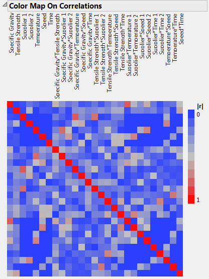

Open the Design Evaluation > Color Map On Correlations outline.
Figure 4.64 Color Map on Correlations
The seven terms corresponding to main effects appear in the upper left corner of the color map. Notice that these seven terms are close to orthogonal. The largest absolute correlation is between Tensile Strength and Supplier 2. This absolute correlation of about 0.43 is a consequence of the available covariate values. (Figure 4.64 uses JMP default colors.)
