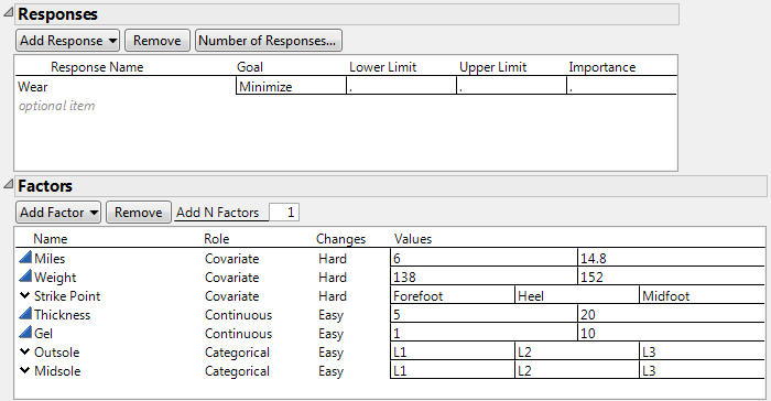

Your company has collected data on 100 suitable runners willing to participate in your study. The concomitant variables (covariates) measured on these runners are average daily miles run (Miles), weight (Weight), and the foot’s strike point (Strike Point).
Select Help > Sample Data Library and open Design Experiment/Runners Covariates.jmp.
Select DOE > Custom Design.
Double-click Y under Response Name and type Wear.
Click Maximize under Goal and change it to Minimize.
5.
Click Add Factor and select Covariate.
6.
Select Miles, Weight, and Strike Point from the list and click OK.
7.
For one of the factors Miles, Weight, and Strike Point, under Changes, click Easy and change it to Hard.
To add the remaining factors manually, follow step 8 through step 16. Or, to load factors from a saved table, select Load Factors from the red triangle menu next to Custom Design. Open the Runners Factors.jmp sample data table, located in the Design Experiment folder. If you select Load Factors, skip step 8 through step 16.
8.
Type 2 next to Add N Factors.
9.
Click Add Factor > Continuous.
10.
Rename the two factors Thickness and Gel.
11.
Change the Values for Thickness to 5 and 20.
12.
Change the Values for Gel to 1 and 10.
13.
14.
Click Add Factor > Categorical > 3 Level.
15.
Rename the two factors Outsole and Midsole.
Keep the default Values for these factors.
Figure 4.65 Responses and Factors Outlines
16.
Click Continue.

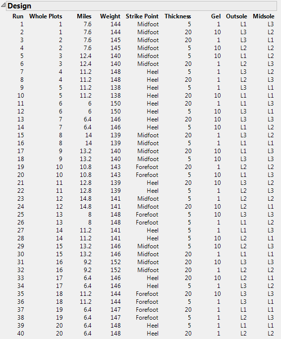

17.
Select Interactions > 2nd.
Note: Setting the Random Seed in step 20 and Number of Starts in step 21 reproduces the exact results shown in this example. In constructing a design on your own, these steps are not necessary.
20.
(Optional) From the Custom Design red triangle menu, select Set Random Seed, type 12345, and click OK.
21.
(Optional) From the Custom Design red triangle menu, select Number of Starts and set it to 1(if it is not already set to that number). Click OK.
22.
Click Make Design.
Figure 4.66 First 40 Runs of Design for Hard-to-Change Covariates
Of the 100 runners, 32 are selected based on their covariate values. The rows corresponding to the selected runners are selected in the RunnersCovariates.jmp sample data table. Settings of the experimental factors Thickness, Gel, Insole, and Outsole are determined so that the design is optimal for the model described in the Model Outline.

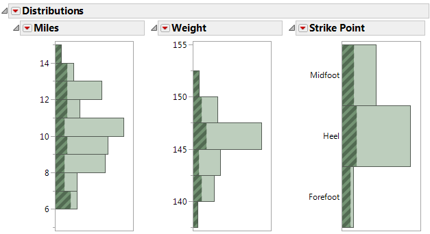

23.
With the RunnersCovariates.jmp sample data table as the active table, select Analyze > Distribution.
25.
Check Histograms Only.
26.
Figure 4.67 Histograms for 100 Runners with Selected Runner Data Shaded
