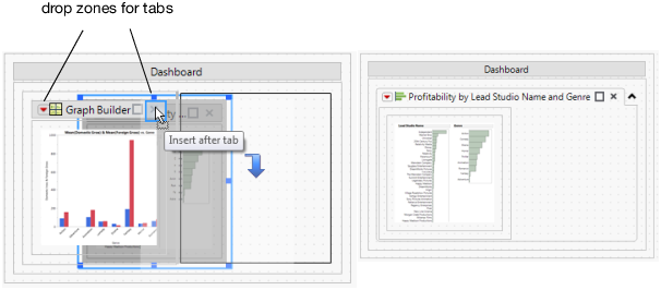

Figure 10.4 shows how to create tabbed reports. To put the Distribution report inside a tab, drag the report over the other report until the upper right corner of the bar chart report is highlighted. The Distribution report appears in a tab on top of the other report.

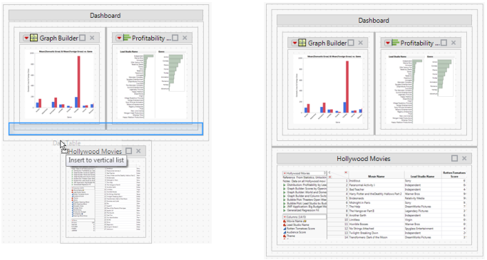

Figure 10.5 shows an example of placing a data table inside the bottom border of the report.
To display the data table below the report instead of inside it, drag the Data Table box onto the dashboard below the report. The box snaps inside the bottom border of the report.
Figure 10.5 Displaying a Data Table Inside a Report

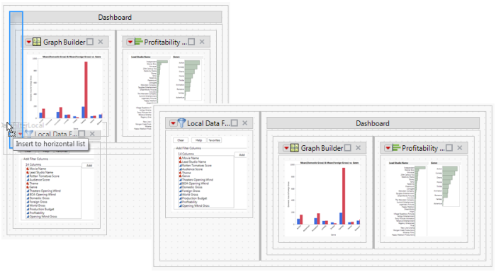

Figure 10.6 shows a data filter that appears to the left of a report.
Figure 10.6 Adding a Data Filter to the Left of a Report

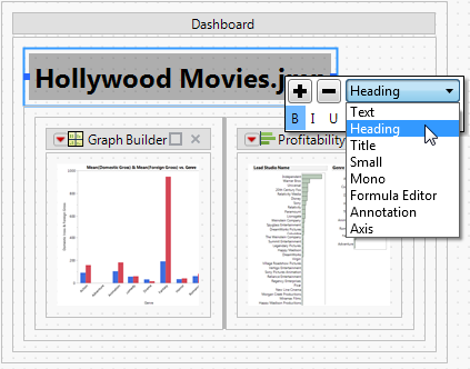

When you edit a dashboard, you can format text in a text box. Drag the text box to the dashboard and click the middle of the text box. Formatting options appear (Figure 10.7).
Figure 10.7 Formatting Options for a Text Box
