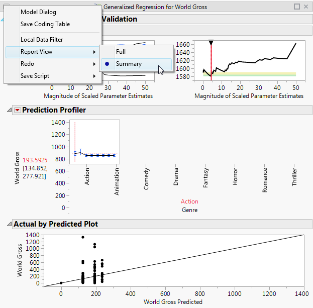

A report that contains graphs and statistics can grow fairly large. To view only the graphs while running the report, select the top red triangle in a report and then select Report View > Summary. The report shown in Figure 10.8 originally showed parameter estimates. In the Summary view, only the graphs are shown.
Figure 10.8 Viewing a Summary of the Report

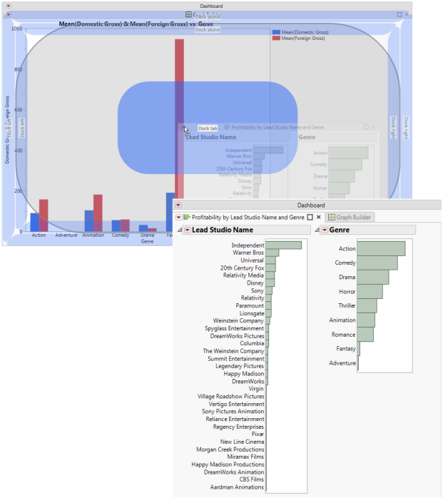

You rearrange reports in a running dashboard by dragging the reports into highlighted drop zones. The drop zones indicate where you can place the report. Figure 10.9 shows an example of moving a report into a tab. The Distribution report is dropped inside the “Dock tab” drop zone to place it on the first tab.
Figure 10.9 Creating Tabbed Reports in a Running Dashboard

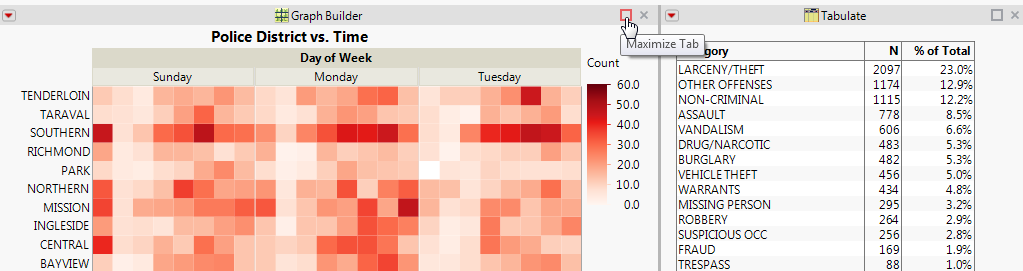

To see only a specific report while running a dashboard, select the report’s Maximize Tab box (Figure 10.10). Note that the box is named Maximize Tab even if the reports are not in tabs.
Figure 10.10 Maximizing a Tab

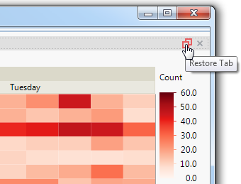

Figure 10.11 Restoring a Maximized Report

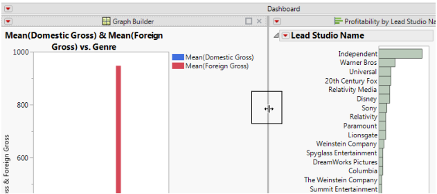

The thick gray line that appears between reports in a dashboard is called a splitter. Drag the splitter to resize the panes. When the pane is too wide to display the enclosed report, the pane closes. Drag the splitter from the outer edge of the dashboard to see all reports again. Figure 10.12 shows the collapsed and expanded reports.
Figure 10.12 Resizing Panes in a Running Dashboard
