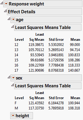

The Effect Details report, shown in Figure 2.10, shows reports for each of the three effects. Least Squares Means tables are given for age and sex, but not for the continuous effect height. Notice how the least squares means differ from the sample means.
Figure 2.10 Least Squares Mean Table

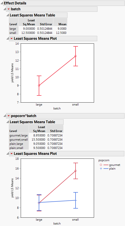

The LSMeans Plot option produces a Least Squares Means Plot for nominal and ordinal main effects and their interactions. If the effect is an interaction, this option displays the Least Squares Means Plot Options window. See Least Squares Means Plot Options.
Figure 2.11 Least Squares Means Plot Options Window

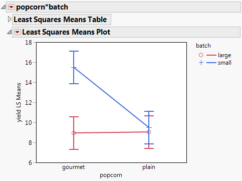

Select LSMeans Plot from the popcorn*batch red triangle menu. The Least Squares Means Plot Options window appears.
9.
10.
11.
Click OK.
12.
13.
Figure 2.13 shows the popcorn*batch interaction plot with the factors transposed. Compare it with the plot in Figure 2.12. These plots depict the same information but, depending on your interest, one might be more intuitive than the other.

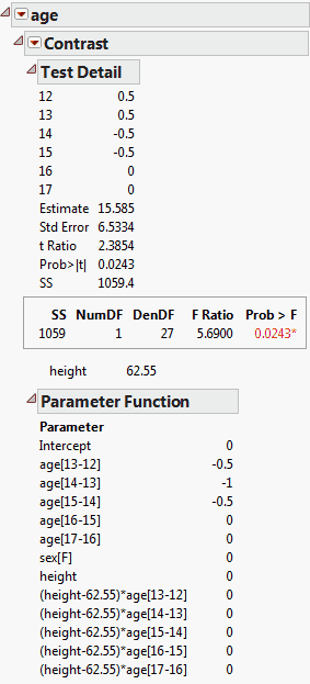

The Test Detail report (Figure 2.15) shows a column for each contrast that you tested. For each contrast, the report gives its estimated value, its standard error, a t ratio for a test of that single contrast, the corresponding p-value, and its sum of squares.
The Parameter Function report (Figure 2.15) shows the contrasts that you specified expressed as linear combinations of the terms of the model.

The Contrast report is shown in Figure 2.15. The test for the contrast is significant at the 0.05 level. You conclude that the predicted weight for age 12 and 13 children differs statistically from the predicted weight for age 14 and 15 children at the mean height of 62.55.
Figure 2.15 LSMeans Contrast Report

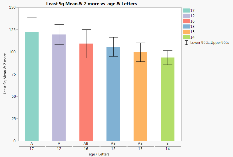

In Figure 2.16, levels 17, 12, 16, 13, and 15 are connected by the letter A. The connection indicates that these levels do not differ at the 0.05 significance level. Also, levels 16, 13, 15, and 14 are connected by the letter B, indicating that they do not differ statistically. However, ages 17 and 14, and ages 12 and 14, are not connected by a common letter, indicating that these two pairs of levels are statistically different.
Figure 2.17 shows the bar chart for an example based on Big Class.jmp. Run the Fit Model data table script, select LSMeans Tukey HSD from the red triangle menu for age. Select Save Connecting Letters Table from the LSMeans Differences Tukey HSD report. Run the Bar Chart script in the data table that appears.

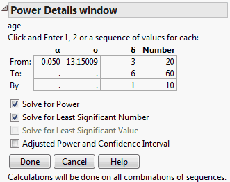

Figure 2.19 shows an example of the Power Details window for the Big Class.jmp sample data table. Using the Power Details window, you can explore power for values of alpha (α), sigma (σ), delta (δ), and Number (study size). Enter a single value (From only), two values (From and To), or the start (From), stop (To), and increment (By) for a sequence of values. Power calculations are reported for all possible combinations of the values that you specify.
Figure 2.19 Power Details Window
