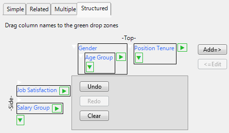

This example uses the Consumer Preferences.jmp sample data table to compare job satisfaction and salary against gender by age group and position tenure to explore using the Structured tab.
Select Analyze > Consumer Research > Categorical.
5.
6.
7.
8.
Figure 3.25 Structured Tab Report Setup
9.
Click Add=>.
10.
Click OK.
11.

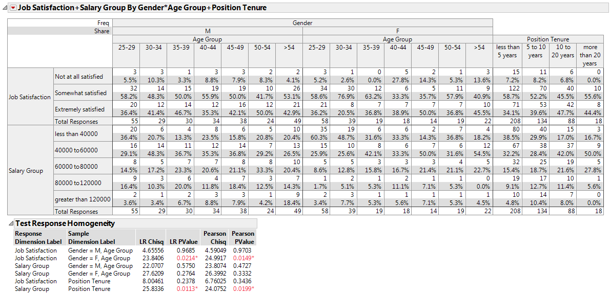

Click the Categorical red triangle and select Test Response Homogeneity.
Figure 3.26 Structured Tab Report Example
The structured tab report contains the table that you specified in the structured tab. The tests for response homogeneity are for each combination of grouping variables. We see that, for males, there is no difference in job satisfaction across age groups (Pearson p-value = 0.9703). For women, there is a difference in job satisfaction across age groups (Pearson p-value = 0.0149). The middle aged women tend to be the least satisfied with their jobs. Share and frequency charts can be added to your report to visualize your results.
