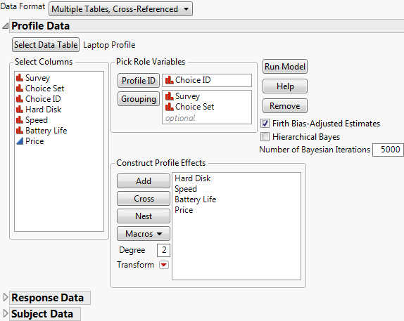

Click Select Data Table under Profile Data and select Laptop Profile.jmp. Select Choice ID and click Profile ID.
6.
Select Hard Disk, Speed, Battery Life, and Price and click Add.
7.
Select Survey and Choice Set and click Grouping.
Figure 4.22 Profile Data Window for Laptop Study

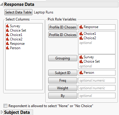

Open the Response Data outline.
9.
From the Select Data Table list, select Laptop Runs.jmp.
Select Response and click Profile ID Chosen.
Select Choice1 and Choice2 and click Profile ID Choices.
Select Person and click Subject ID. The Response Data window is shown in Figure 4.23.
Figure 4.23 Response Data Window for Laptop Study

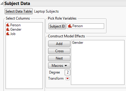

Open the Subject Data outline.
12.
From the Select Data Table list, select Laptop Subjects.jmp.
13.
14.
Select Gender click Add.
Figure 4.24 Subject Data Window for Laptop Study

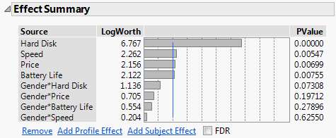

Figure 4.25 Laptop Effect Summary
The Effect Summary report shows that Hard Disk is the most significant effect. You can reduce the model by removing terms with a p-value greater than 0.15. This process should be done one term at a time. Here, Gender*Speed is the least significant effect, with a p-value of 0.625.
In the Effect Summary report, select Gender*Speed and click Remove.
Figure 4.26 Laptop Results
Once Gender*Speed is removed from the model, all effects have a p-value of 0.15 or less. Therefore, you use this as your final model.

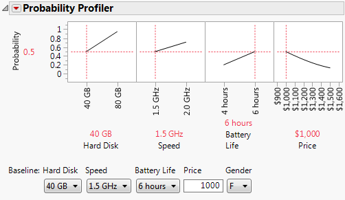

In the Laptop Runs. jmp sample data table, click the green triangle next to the Choice Reduced Model script.
Note that the Probability Profiler is for Gender = F. You can change this later.
Figure 4.29 Probability Profiler with Text Entry Area for Price

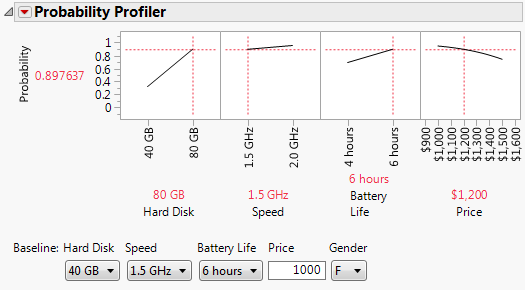

Figure 4.30 Laptop Probability Profiler Results with Baseline Effects

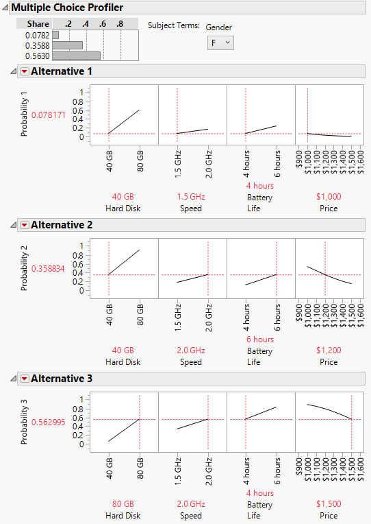

In the Laptop Runs.jmp sample data table, click the green triangle next to the Choice Reduced Model script.
For Alternative 1, set Hard Disk to 40 GB, Speed to 1.5 GHz, Battery Life to 4hours, and Price to $1,000.
5.
For Alternative 2, set Hard Disk to 40 GB, Speed to 2.0 GHz, Battery Life to 6 hours, and Price to $1,200.
6.
For Alternative 3, set Hard Disk to 80 GB, Speed to 2.0 GHz, Battery Life to 4 hours, and Price to $1,500.
Figure 4.31 Multiple Choice Profiler for Females

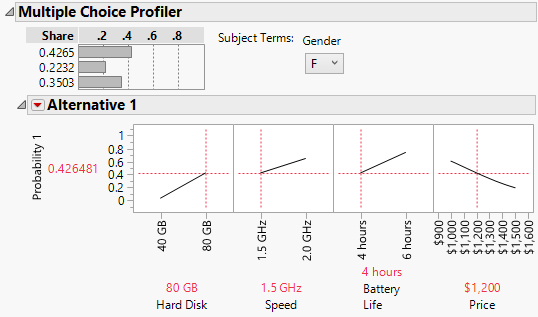

For Alternative 1, set Hard Disk to 80 GB and Price to $1,200.
Figure 4.32 Multiple Choice Profiler with Improved Laptop
