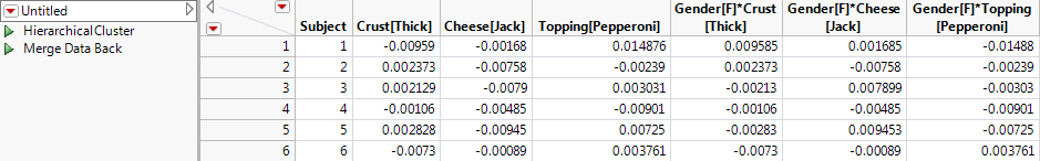

Click the green triangle next to the Choice script.
Click the Choice Model red triangle and select Save Gradients by Subject.

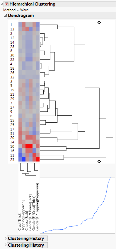

Click the green triangle next to the Hierarchical Cluster script.
Figure 4.34 Dendrogram of Subject Clusters for Pizza Data
The script runs a hierarchical cluster analysis on all columns in the gradient table, except for Subject. Click on either diamond to see that the rows have been placed into three clusters.
5.
A new column called Cluster is added to the data table containing the gradients. Each subject has been assigned a Cluster value that is associated with other subjects having similar gradient forces. See Hierarchical Cluster in the Multivariate Methods book for a discussion of other Hierarchical Clustering options.

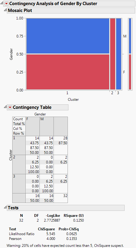

Click OK.
Figure 4.36 Contingency Analysis of Gender by Cluster
