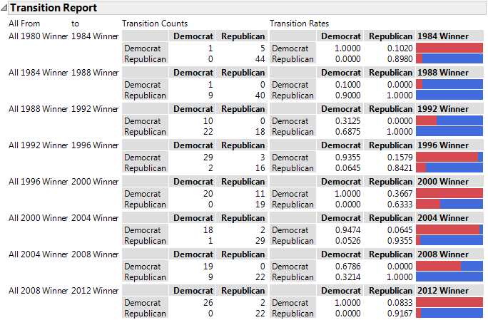

This example uses the Presidential Elections.jmp sample data table, which contains United States presidential election results for each state from 1980 through 2012. Use this data to explore Repeated Measures where we consider the election results the repeated measures.
Select Analyze > Consumer Research > Categorical.
On the Related tab, click Repeated Measures.
5.
Click OK.
Figure 3.17 Repeated Measures Transition Report
