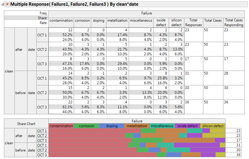

Figure 3.18 Multiple Response Report

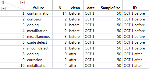

The Failure3ID.jmp sample data table has a row for each defect type within each batch, a column for the number of each defect type, and an ID column for each batch.
Figure 3.19 Failure3ID Data Table (Partial Table)

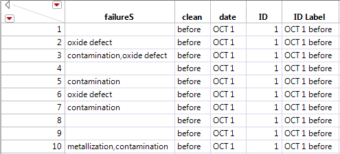

The Failures3Delimited.jmp sample data table has a row for each unit with a single column in which the defects are recorded, delimited by a comma. Note in the partial data table, shown in Figure 3.20, that some units did not have any observed defects, so the failureS column is empty.
Figure 3.20 Failure3Delimited.jmp Data Table (Partial Table)

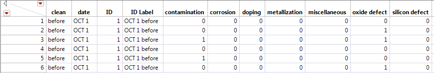

The Failures3Indicators.jmp sample data table has a row for each unit and indicator columns for each defect type. The data entry in each defect columns is a 0 if that defect was not observed and a 1 if the defect was observed for the unit.
Figure 3.21 Faliure3Indicators.jmp Data Table (Partial Table)

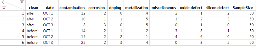

The Failure3Freq.jmp sample data table has a row for each batch, columns for each defect type, and a column for the batch size. The data entries in the defect columns are the frequency of occurrence of the defect in the batch.
Figure 3.22 Failure3Freq.jmp Data Table

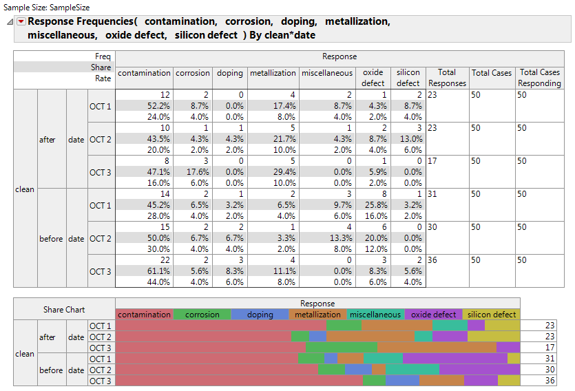

Figure 3.23 Defect Rate Output
The resulting output is the same as that in Figure 3.18 with the exception of the Total Cases Responding column in the Crosstab table. Here, the defect data was summarized. From the summarized table, there is no record of the number of units with zero defects. Thus, the Total Cases Responding is the full batch size of 50 for each batch.
