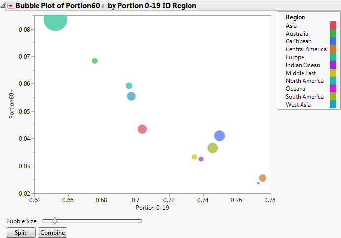

The initial report window appears. (Figure 7.9 uses the default JMP colors.)
Figure 7.9 Initial Report Window with ID Variables
9.

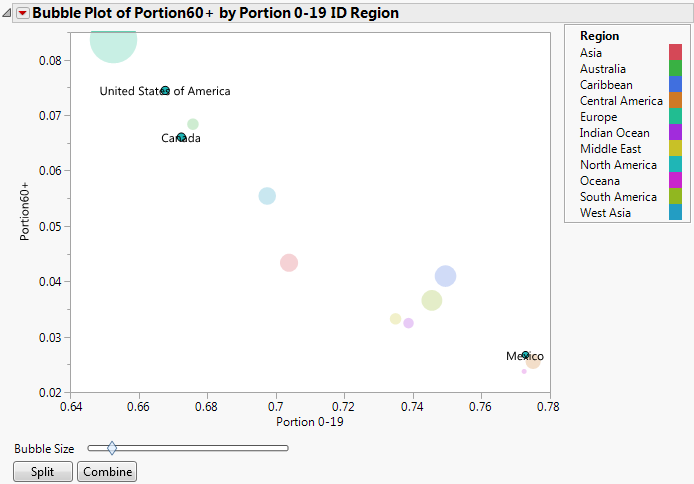

Click Split.
Figure 7.10 Splitting the North America Bubble
