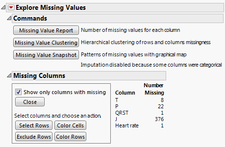

Select Analyze > Screening > Explore Missing Values.
Select all columns (280 in all) and click Y, Columns.
Figure 2.11 Missing Value Report
The Missing Columns report shown in Figure 2.11 indicates that only five columns have missing data. Out of a total of 452 rows, Column J has 376 missing values. Because it is largely missing, it is not useful for data analysis, even with imputed values. However, it might be useful to model Column J using the Informative Missing option in a platform that supports this option to see whether values are perhaps not missing at random.

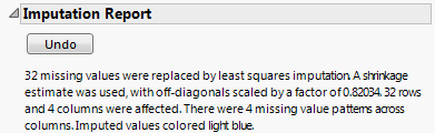

Click Multivariate Normal Imputation.
8.
Click Yes Shrinkage.
A JMP Alert appears, informing you that you should use the Save As command to preserve your original data.
9.
Click OK.
Figure 2.12 Imputation Report
The Imputation Report in Figure 2.12 indicates how many missing values were imputed and the specific imputation details. No missing data remain in the four columns that had missing values.
