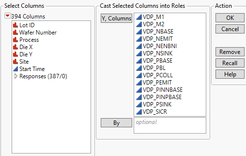

Select Analyze > Screening > Explore Outliers.
Select columns VDP_M1 through VDP_SICR and click Y, Columns. There should be 14 columns selected (see Figure 2.2).
Figure 2.2 Explore Outliers Launch Window
Click OK.

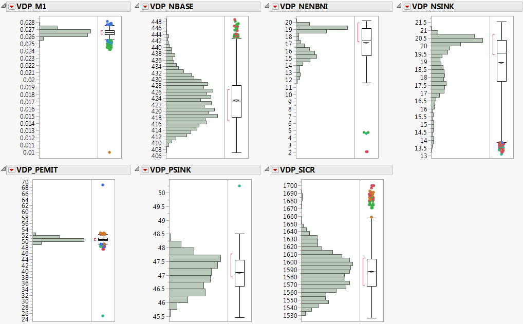

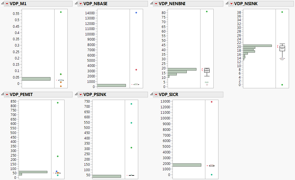

Select Analyze > Distribution.
Assign the selected columns to the Y, Columns role. Because you selected these column names in the Quantile Range Outliers report, they are already selected in the Distribution launch window.
5.
Click OK.
Figure 2.3 shows a simplified version of the report.
In columns VDP_M1 and VDP_PEMIT, notice that the selected outliers are somewhat close to the majority of data. For the rest of the columns, the selected outliers appear distant enough to exclude them from your analyses.
