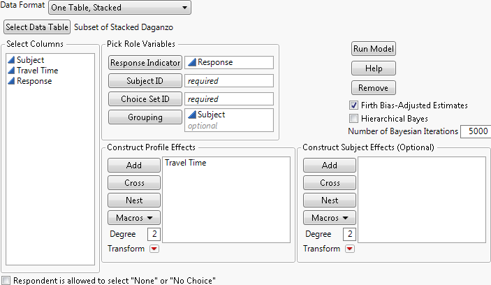

Select Analyze > Consumer Research > Choice to open the launch window and specify the model as shown in Figure 4.54.

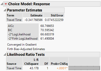

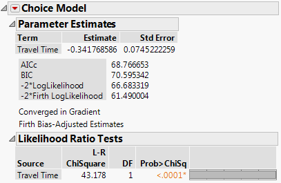

Click Run Model.
