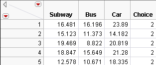

Consider the data from Daganzo, found in Daganzo Trip.jmp. This data set contains the travel time for three transportation alternatives and the preferred transportation alternative for each subject.
Select Help > Sample Data Library and open the Daganzo Trip.jmp data table.
Figure 4.43 Partial Daganzo Trip Table

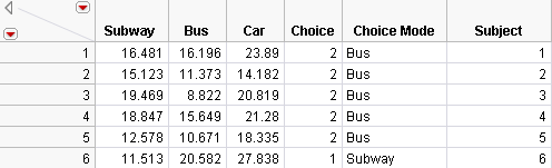

The new Choice Mode column appears in the data table. Because each row contains a choice made by each subject, another column containing a sequence of numbers should be created to identify the subjects.
9.
Select Cols > New Columns.
11.
Click Missing/Empty next to Initialize Data and select Sequence Data.
12.
Figure 4.45 Partial Daganzo Trip Data with New Choice Mode and Subject Columns

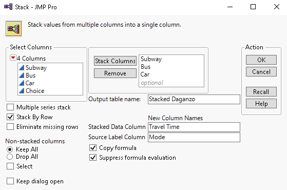

Select Tables > Stack.
Select Subway, Bus, and Car and click Stack Columns.
For the Output table name, type Stacked Daganzo. Type Travel Time for the Stacked Data Column and Mode for the Source Label Column.
Figure 4.46 Stack Dialog for Daganzo Data

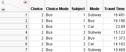

Figure 4.47 Partial Stacked Daganzo Table

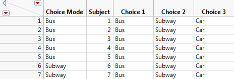

The columns Choice 1, Choice 2, and Choice 3 have been added.
11.
Type “Bus” (without quotation marks) in the first row of Choice 1. Right-click the cell and select Fill > Fill to end of table.
12.
Type “Subway” (without quotation marks) in the first row of Choice 2. Right-click the cell and select Fill > Fill to end of table.
13.
Type “Car” (without quotation marks) in the first row of Choice 3. Right-click the cell and select Fill > Fill to end of table.
Figure 4.49 Partial Subset Table of Daganzo Data with Choice Set

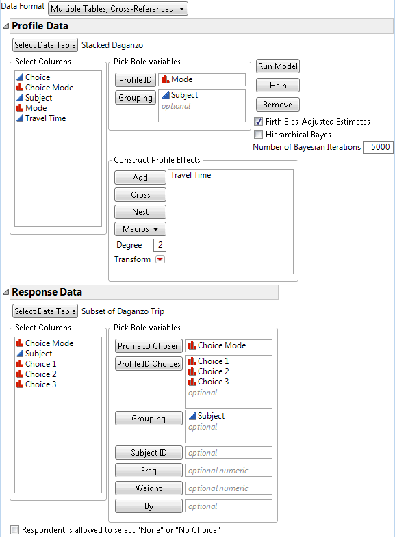

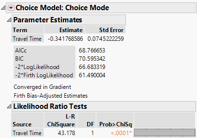

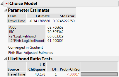

Now that you have separated the original Daganzo Trip.jmp table into two separate tables, you can run the Choice Platform.
Select Analyze > Consumer Research > Choice.
From the Data Format list, select Multiple Tables, Cross-Referenced.
Figure 4.50 Choice Dialog Box for Subset of Daganzo Data
Click Run Model.
Figure 4.51 Parameter Estimate for Travel Time of Daganzo Data
