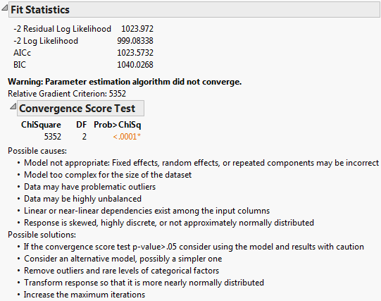

If there are problems with model convergence, a warning message is displayed below the fit statistics. Figure 7.11 shows the warning that suggests the cause and possible solutions to the convergence issue. It also includes a test of the relative gradient at the final iteration. If this test is non-significant, the model might be correct but not fully reaching the convergence criteria. In this case, consider using the model and results with caution. For more information, see Convergence Score Test.
Figure 7.11 Convergence Score Test
Fit Statistics
