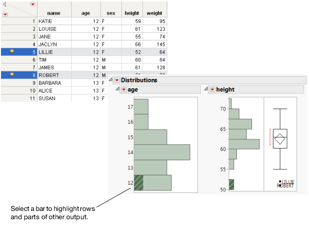

Clicking on a histogram bar highlights the bar and selects the corresponding rows in the data table. The appropriate portions of all other graphical displays also highlight the selection. Figure 2.6 shows the results of highlighting a bar in the height histogram. The corresponding rows are selected in the data table.
Figure 2.6 Highlighting Bars and Rows
