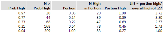

Figure 4.19 Lift Table for Lift Curve
Figure 4.19 provides a table of values to demonstrate the calculation of Lift and Portion used for the High lift curve shown in Figure 4.18. A partition model with five splits was built to predict the response, Y Binary. Y Binary has two levels: Low and High. The lift curve is based on 309 observations. There are 83 observed High responses for an overall rate of 0.27.
Prob High: The five unique predicted probability values from the partition model for the High response level.
N > Prob High: The number of observations that have a predicted probability value equal to or greater than the value in Prob High.
Portion: N > Prob High divided by 309, the total number of observations.
N High in Portion: The number of observations in each portion that have an observed High response.
Lift: Portion High divided by 0.27, the overall rate of the observed High response.
