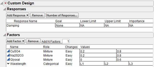

From the Custom Design red triangle menu, select Load Factors.
Figure 4.52 Responses Outline and Factors Outline

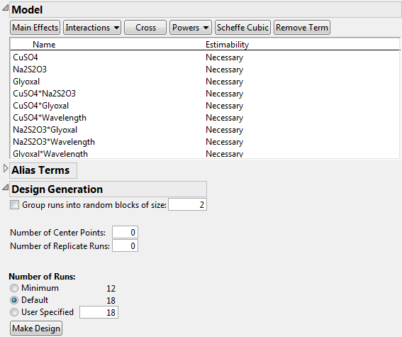

In the Model outline, click Interactions > 2nd.
An informational JMP Alert window reminds you that JMP removes the main effect terms for non-mixture factors that interact with all the mixture factors. This means that the main effect of Wavelength is removed, but all two-way interactions of mixture factors with Wavelength are added.
6.
Click OK to dismiss the message.
The effects in the Model outline define a response surface model in the mixture ingredients along with the additive effect of the wavelength. See Scheffé (1958).
Figure 4.53 Model and Design Generation Outlines

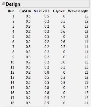

Click Make Design.
Figure 4.54 Design Outline Showing 18-Run Design

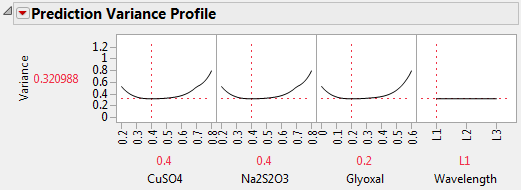

Figure 4.55 Prediction Variance Profile for 18-Run Design
Move the slider for Wavelength to verify that the relative prediction variance profiles for the mixture factors do not change across the levels of Wavelength. Move the slider for any one of the mixture factors. The sliders for the other two mixture factors adjust to make the mixture ingredients sum to one. Notice that the smallest relative prediction variances occur near the center settings for the mixture factors.
From the Prediction Variance Profile red triangle menu, select Maximize Variance.

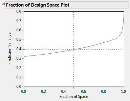

Open the Fraction of Design Space Plot outline.
Figure 4.56 Fraction of Design Space Plot for 18-Run Design
Over the entire design space, the relative prediction variance is below 0.8. The minimum relative prediction variance is about 0.32. As seen in Figure 4.55, the minimum occurs near the center settings for the mixture factors.
