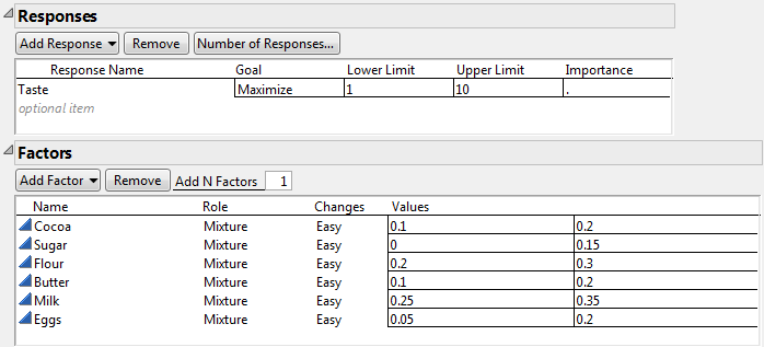

Consider the ingredients that go into a cake. Dry ingredients include flour, sugar, and cocoa. Wet ingredients include milk, melted butter, and eggs. The wet and dry components of the cake are two mixtures that are first mixed separately and then blended together. Table 4.1 lists the factors and the ranges over which you vary them as part of your experiment.
Select DOE > Custom Design.
Note that the default goal is Maximize. Because you want to maximize the Taste rating, do not change the goal.
6.
From the Custom Design red triangle menu, select Load Factors.
7.
Figure 4.58 Completed Responses and Factors Outlines

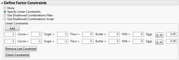

In the Define Factor Constraints outline, select Specify Linear Constraints.
9.
In the Linear Constraints panel, click Add twice.
Figure 4.59 Define Factor Constraints
Note that the second constraint is equivalent to specifying that the sum of Cocoa, Sugar, and Flour is greater than or equal to 0.45. The two constraints together imply that Cocoa, Sugar, and Flour comprise exactly 45% of the mixture, ensuring that the wet factors constitute the remaining 55%.

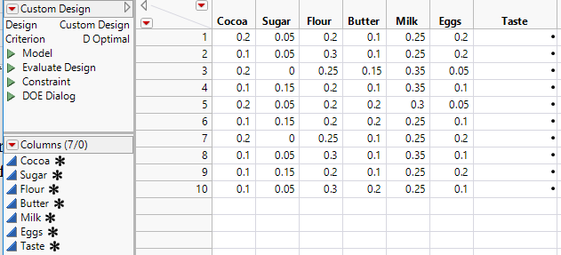

Click Make Design.
16.
Click OK to dismiss the JMP Alert.
17.
Click Make Table.
Figure 4.60 Mixture of Mixtures Design
The settings for the dry ingredients, Cocoa, Sugar, and Flour, sum to 45% of the mixture and the settings for the wet ingredients, Butter, Milk, and Eggs, sum to 55% of the mixture. The settings also conform to the upper and lower limits given in the Factors outline.
The Cake Data.jmp sample data table shows the results of the experiment. (Note that the runs in Cake Data.jmp differ from those shown in Figure 4.60.) The design table contains a Model script that opens a Fit Model window showing the five main effects specified in the DOE window’s Model outline. Notice that the main effect of Eggs is not included in the Model outline for this design. The level of Eggs can be determined by the settings of the other 5 factors and the constraint on the dry ingredients. This script was saved to the data table when it was created by Custom Design.
