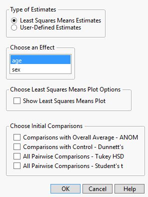

An example of the control window for the Multiple Comparisons option is shown in Figure 2.28. This example is based on the Big Class.jmp data table, with weight as Y and age, sex, and height as model effects. Two classes of estimates are available for comparisons: Least Squares Means Estimates and User-Defined Estimates.
This option compares least squares means and is available only if there are nominal or ordinal effects in the model. Recall that least squares means are means computed at some neutral value of the other effects in the model. (For a definition of least squares means, see LSMeans Table.) You must select the effect of interest. In Figure 2.28, Least Squares Means Estimates for age are specified. There is an option to show the least squares means plot. See Least Squares Means Plot Options.
Figure 2.28 Launch Window for Least Squares Means Estimates

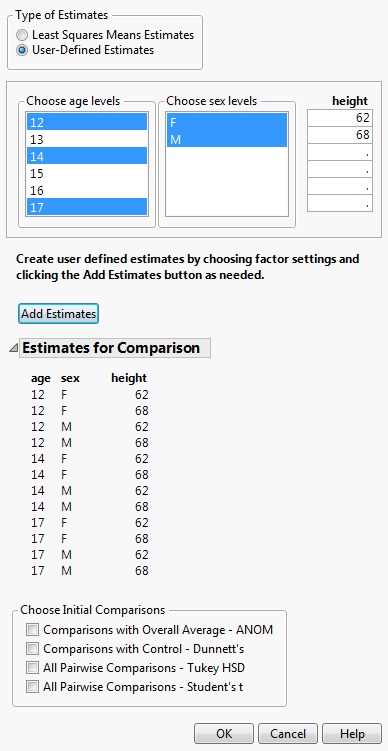

The specification of User-Defined Estimates is illustrated in Figure 2.29. Three levels of age and both levels of sex have been selected. Also, two values of height have been manually entered. The Add Estimates button has been clicked, resulting in the listing of all possible combinations of the specified levels. At this point, you can specify more estimates and click the Estimates button again to add them to the list of Estimates for Comparison.
Figure 2.29 Launch Window for User-Defined Estimates

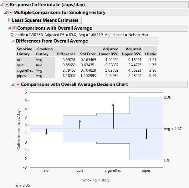

Consider the Lipid Data.jmp sample data table. You are interested in whether any of the four Smoking History categories are unusual in that their mean Coffee intake (cups/day) differ from the overall average coffee intake while controlling for alcohol use and heart history. You specify a model with Coffee intake (cups/day) as the response and Smoking History, Alcohol Use, and Heart History as model effects.
Select Analyze > Fit Model.
5.
Click Run.
6.
From the red triangle next to Response Coffee intake (cups/day), select Estimates > Multiple Comparisons.
7.
From the Choose an Effect list, select Smoking History.
8.
In the Choose Initial Comparisons list, select Comparisons with Overall Average - ANOM.
9.
Click OK.
The results shown in Figure 2.30 indicate that the least squares means for non-smokers and cigarette smokers differ significantly from the overall average in terms of coffee intake.

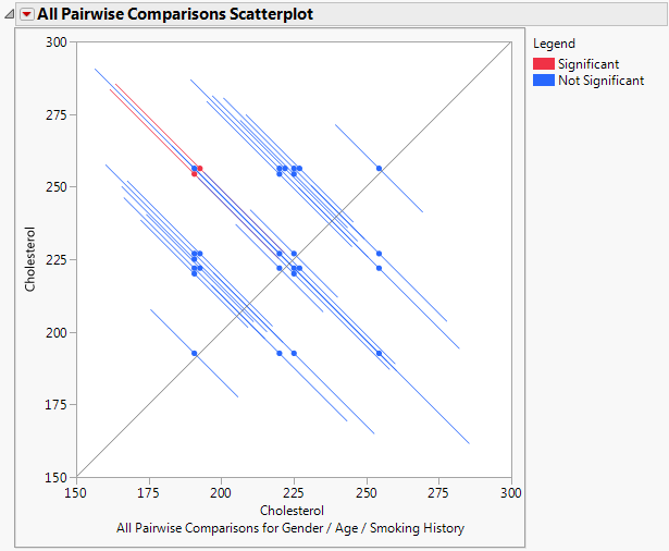

This plot, sometimes called a diffogram or a mean-mean scatterplot, displays the confidence intervals for all means pairwise differences. (See Figure 2.32 for an example.) Colors indicate which differences are significant.

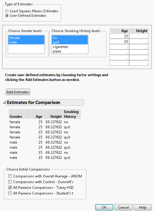

Consider the Lipid Data.jmp sample data table. You are interested in Cholesterol differences for gender and non-smokers versus former smokers (Smoking History equal to no and quit, respectively) across two ages (25 and 35) and average height.
5.
Click Run.
6.
From the red triangle next to Response Cholesterol, select Estimates > Multiple Comparisons.
7.
From the Type of Estimates list, click User-Defined Estimates.
8.
From the Choose Gender levels list, select female (it should already be selected by default) and male.
9.
10.
In the Age list, enter the ages 25 and 35 in the first two rows.
Do not enter any values in the list entitled Height. Because no values for Height are specified, the mean value of the Height column is used in the multiple comparisons report.
11.
Click Add Estimates.
12.
In the Choose Initial Comparisons list, select All Pairwise Comparisons - Tukey HSD.
Figure 2.31 Populated Used-Defined Estimates Window
13.
Click OK.
The All Pairwise Differences report indicates that two of the 28 pairwise comparisons are significant. The All Pairwise Comparisons Scatterplot, shown in Figure 2.32, shows the confidence intervals for these comparisons in red. You can place your pointer over any of the points to determine which pairwise comparison the point represents. The tooltips also contain the difference between the two levels in the comparison. The two red points in Figure 2.32 represent the points comparing 35-year-old former smokers to 25-year-old non-smokers, for both females and males.
confidence interval for the difference in the means.
confidence interval for a pairwise comparison. The coordinates of the point on the line segment are the means for the corresponding groups. Placing your cursor over one of these points displays a tooltip indicating the groups being compared and the estimated difference. When a line segment is entirely contained within the diagonal band, it follows that the means are practically equivalent.
